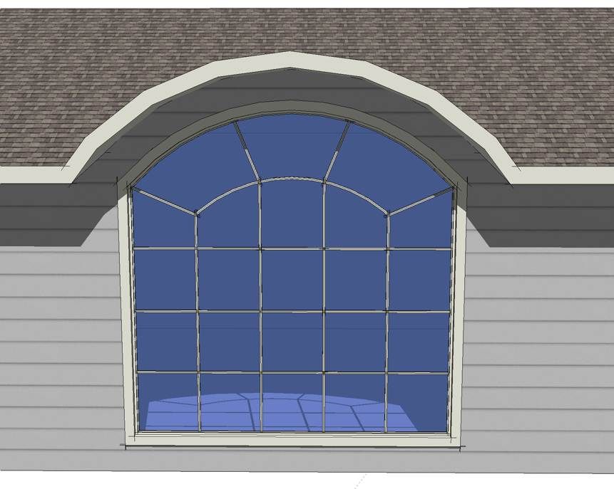

Eyebrow Roof?
I'm trying to make an eyebrow roof over a window. These are SketchUp examples.
Thanks,
Rich
[/img]
3 REPLIES 3
Another View,
Thanks,
Rich
Dwight
- Make a shallow dome roof matching the arc of your eyebrow.
[There's that automatic roof tool option for that....]
[You can use the tangent line roof tool, but it is not as predictable]
- select one arc of segments from base to apex.
- delete the rest of the segments.
- extend these parts into the shape of one half of the eyebrow roof.
- Mirror a copy.
- Viola.
Dwight Atkinson
It worked perfectly!
Thanks,
Rich
