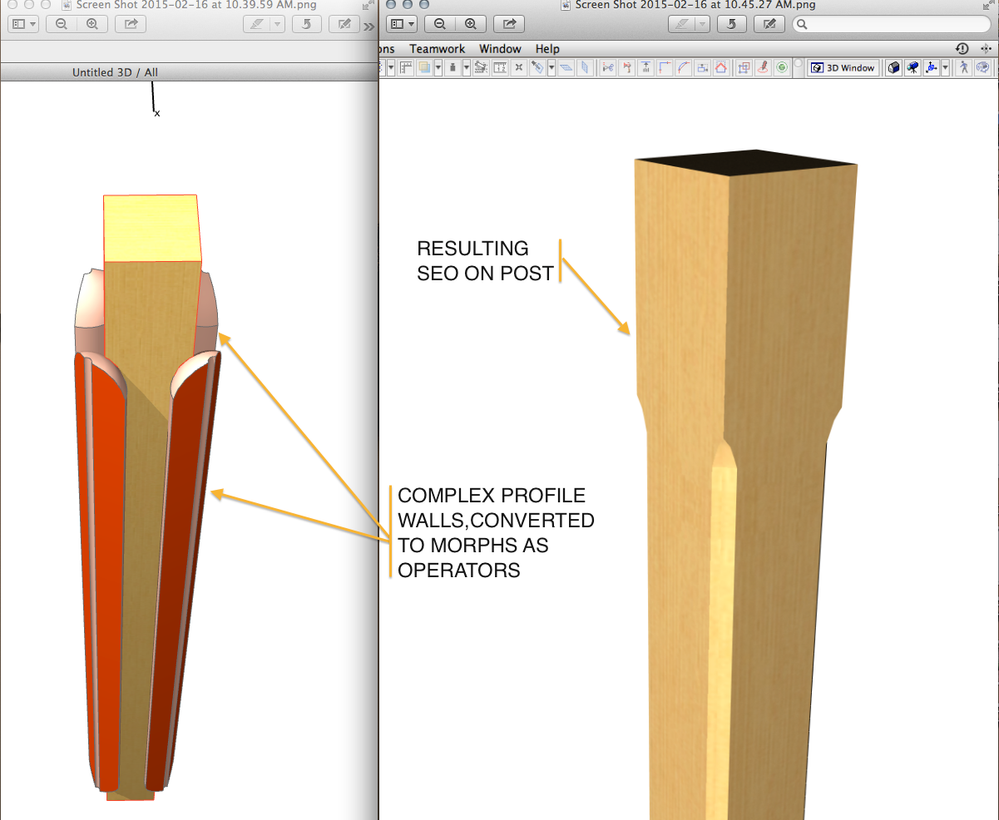

A year ago we used the Morph tool to make an SEO to acheive the result shown. Unfortunately ,due to my broken brain,the Morph wasn't saved and is long lost……:oops:
I haven't been able to repeat the method used to get the morph shape required!
Does anyone have a method that works for this or are there videos out there.

Create a 90 degree revolved morph object to match the "flute" and SEO subtract it from the "column"?

Making the body of the operator as a cylindrical morph is no problem,I just can't remember what I did to round off the ends!

Use a Complex profile wall rotated at least 90 degrees. You can achieve the full chamfer, curved ends and all. It can also be converted to a morph if need be.

Thank you Erich and Splilid…..both excellent solutions

MrC,
The original operator for you column must be on a hidden layer unless the column has been converted to a morph or saved as an object.
So to get the exact same cutout as on your original post you could have a look on the hidden layers for the original operator.
Or use this column morph or object as the operator in an SEO and subtract it from a slab (target) you have placed on the corner over the cutout on the morph/object.
This will result in the exact same cutout which you could then save as a morph for use again on any other column.
Of course you could then edit this morph if you wanted to make it different or just create a new operator as described before.

Yes the post was converted to an object and used throughout the project,for which I still have the archived pln. The problem was that before saving the pln I think we deleted some layers and the morph operator was one of them.
However all the above advice ,including DGSketchers idea,have put us back on track.! THANKS TO YOU ALL.
