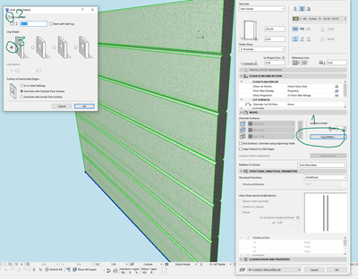

Hi, I'm trying to figured out how to make properly profiles for facades walls - which they have a gabs or some 3D textures
- Profile manager it's seem that can do profile only : TopSurface and after this profile I can use it for FrontSurface - Not like SideSurface
- Also tried to do this troughs NISH window object - It's do very well but it not easy to change "parametrically" ( Also it's too many windows in the wall after )
- I tested also Texture and it do very well just it's so flat and any change is not exactly and reUplouding Libraries is little pain 😕
- Solid operations tools is also working but it's annoying work with it ( hiding layers ...)
Skärmavbild 2022-04-19 kl. 10.18.55.jpgSkärmavbild 2022-04-19 kl. 10.19.06.jpg
- Last what I know is using CurtainWalls but they are so heavy for projects and I want to combine  with windows and doors from the wall. this tool is not my favorit too
•  Is there something how to do it more simple or easier ?
• I'm looking for something solid operation tool but what it give me FrontSurface to profile my Walls
• Can I use it PARAOM for this ?
I hope you understand what I want is quite hard to explain 😇 I wanna do just Wall but with 3D texture and right now I will be very happy if I can do just some Lines / gabs in the walls but be able to applicate for whole house with possibilities to change dimension/positions of gabs

i hope this helps, it is really easy to use.
Archicad 26, build 3001
Montenegro
Wau this is quite interesting solution thanks

My free wall coverings do this.
Thank's. i
I'm not gonna lie it's little bit hard to navigate in your tools 😇
Unfortnately I have no Idea how it working 😕
AC 7 - 27 SWE
iMac (Retina 5K, 27-inch, 2020),
3,6 GHz 10-Core intel Core i9, 64 GB 2667 MHz DDR4, AMD Radeon Pro 5700 XT 16 GB
Lol I am aware, they are still being developed.
I will make a video soon.
can you rotate the orientation with this? or just purely horizontal? 🤔
In the end what is your Objective?
ArchiCAD 9 onwards
It is purely horizontal.
It is just turning the wall into horizontal logs.
I see, interesting feature but not much control for the sizing of grooves, if you really intend to use it for groove lines. I think for me I will still prefer using complex profiles, but good to know. 😊
