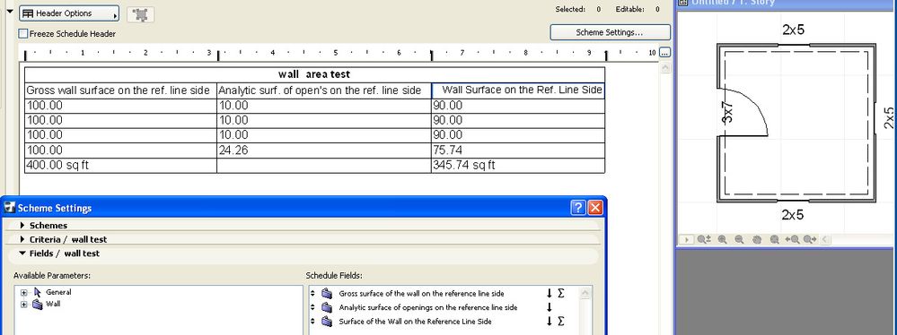

Ideally, you could create a schedule that will give you this figure. Create a schedule of walls as shown. I created a building 10'x10' with walls 10' high
The left column gives the gross area of the walls on the reference line side as I put the reference lines of the exterior walls on the outside face of the wall. If your ref lines are on the inside face of the exterior walls, then call that parameter in your schedule.
The middle column gives the area of the openings. Note windows are shown unit size as desired, the door area unfortunately by default the r.o., probably not what you want, but I include to show schedule limitations.
The right column shows the net wall area (gross less wall openings). You could easily correct the door areas and quickly get the real net area of the exterior walls.
The advantage to the schedule is this is live i.e. it will update with the development of your design.
There are other discussions here about the problems with the R.O. v.Unit Size i.e. inconsistencies in the Interactive Schedule
