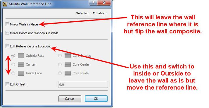

Is there a shortcut for the opposite - to flip reference line on wall?
I notice that I often need to keep the walls in place but have reference lines that need to be corrected or made to be consistent.
There is an option to [mirror wall in place], but this requires two steps [modify wall reference line] + [mirror wall in place]
regards
Haneef Tayob
Aziz Tayob Architects
AC23 INT rel 3003, OS X 10.14.6 iMac 3.3ghz i5 dual monitor, 24GB RAM
No direct shortcut that I can see but in "Modify wall reference line" (which you can set up a shortcut too) you want to choose the option for "Edit reference line location" and then choose either the Inside or Outside.
The wall will stay were it is and just the reference line will move.
