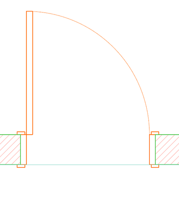

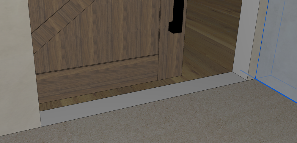

Hi, I'm trying to run floor finish into anther in a door way. The floor finish doesn't show up. Can any one help please. I want to show the timber in the door way with transition strip to the carpet. See screen shot.

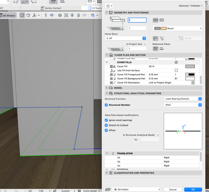

Thank you for your help once again Ling. I'm very new with working with composites. When I go into the slab settings of the floor it doesn't have the composite filed. Is there something else I need to do to convert it into a composite.

Clare:
Change from Basic to Composite here:

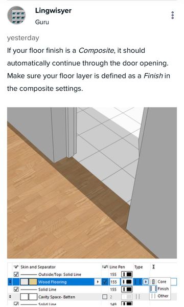

If your floor finish is a Composite, it should automatically continue through the door opening. Make sure your floor layer is defined as a Finish in the composite settings.

Clare:

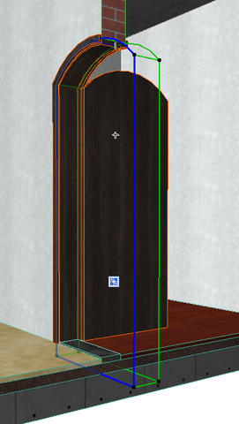

Hi @Clare,
For the case you presented, I can't remember how it was being solved before.
For now, there's a workaround is to create an opening around the door and extend lower the door till the structural slab, that simulates the real construction workflow.
Sure, you have to edit the opening when editing the door, I know it's not a solution, see the attached Screenshots, I hope that temporarily helps.

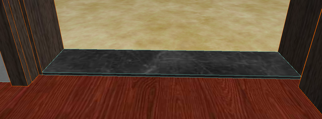

Thank you for your help. Making it a composite did the trick.
Yeah, Thanks @Clare, it really did just if you don't like to use a border, but if you prefer to use border, I think a complex profile wall will be the appropriate solution while using SEO to subtract it from the original wall.
