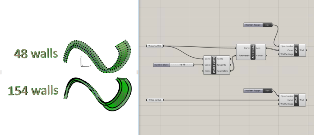

Refining curves for optimized walls/beams
Creating walls/beams based on Rhino or Grasshopper curves may result in too many walls/beams in ARCHICAD. To control the number of these elements in ARCHICAD it is recommended to convert these curves into arcs which are handled better in ARCHICAD.

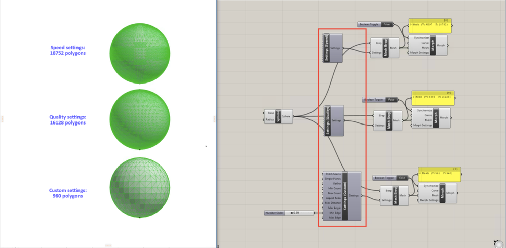

Mesh optimization
Bringing over complex geometries from Grasshopper into ARCHICAD as Morphs may result in too detailed BREPS with too many polygons, which can cause performance issues, in extreme cases crashes. It is recommended to control the number of mesh polygons in Grasshopper before transferring them into ARCHICAD. The screenshot below shows examples for different Mesh BPREP settings and their resulting polygon numbers.

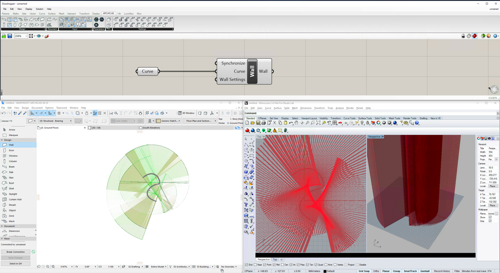

In certain cases seemingly incorrect geometries can be generated in ARCHICAD with the Grasshopper Live connection like the following:
The cause of this is that the Rhino curve was created in millimeters while the default settings for the ARCHICAD wall is 30cm. The issue is that the defining curve for the default ARCHICAD wall is too small and it creates degenerated geometries. Always keep an eye out for the absolute size of the reference models and the Grasshopper number sliders. (eg. the GH definition was set up for a Rhino curve in millimeters and using the same definition for ARCHICAD splines/2D curves will result in a really large model.)

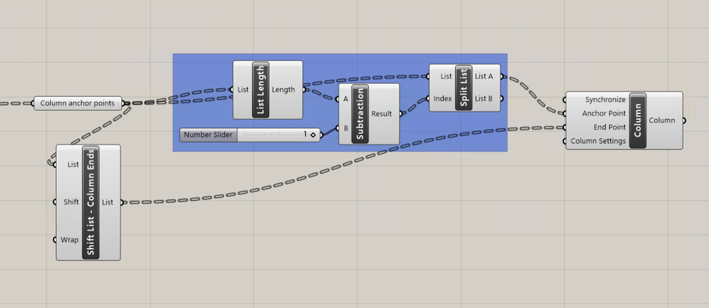

Column creation without degenerated geometry
Creating ARCHICAD columns from Grasshopper is fairly easy with a set of points as column Anchors and shifting this list results in the End Points of the columns:

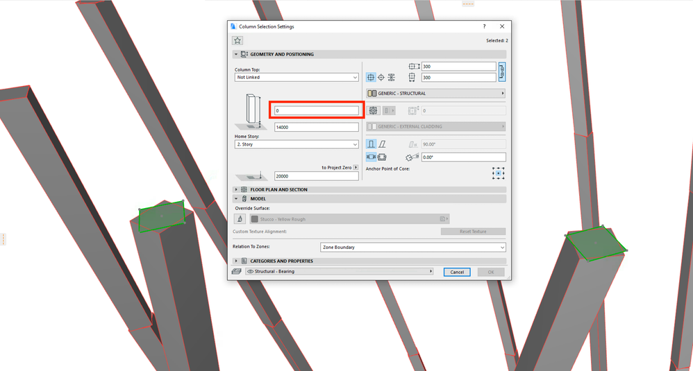

The problem is with this simple setup is that at the top of the column set we get a degenerated zero height set of columns. In extreme cases, this can be quite conspicuous while in other situations it may not be particularly visible while it is creating degenerated geometries and faulty schedule results.
The correct solution for this is to remove the last set of points from the Column Anchors. For example with the split list component:

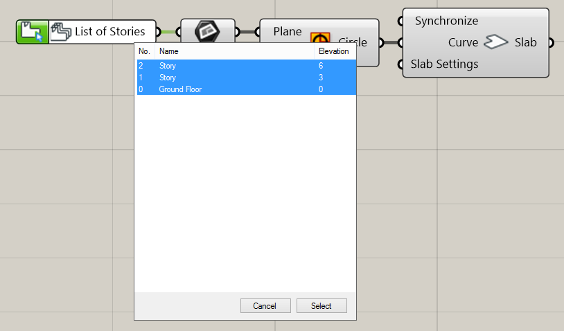

Home Story of Elements
  • Every Grasshopper connection created element's Home Story is defined by its position in the ARCHICAD story system based on its reference lines/anchor points. In the case of Morphs, the geometry's lowest point defines the Home story.
  • With the Story Plane input node, it is possible to extract the story planes of the ARCHICAD project. With these planes in Grasshopper, it is easy to place geometries on particular Stories in ARCHICAD.
