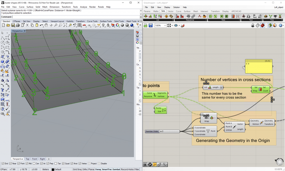

  1. Break down the cross-sections into 3D points. Since this shape has polygonal cross-sections, we can just explode them into vertices.
  1. Count how many points are in each cross-section. Make sure each section has the same amount of points! We used the Delete Consecutive component to get a single number and also verify that all sections have the same number of points.
  1. When you generate an object through the connection tool in ARCHICAD, it will always take the Rhino Model origin as the origin for the object. To avoid creating objects that have their geometry far away from their actual origin, it is suggested to generate the object geometry right in the Rhino Origin, and then place the object in its original position after. To do this we picked the first point of the object as the insertion point, and moved every point into the origin relative to this point.

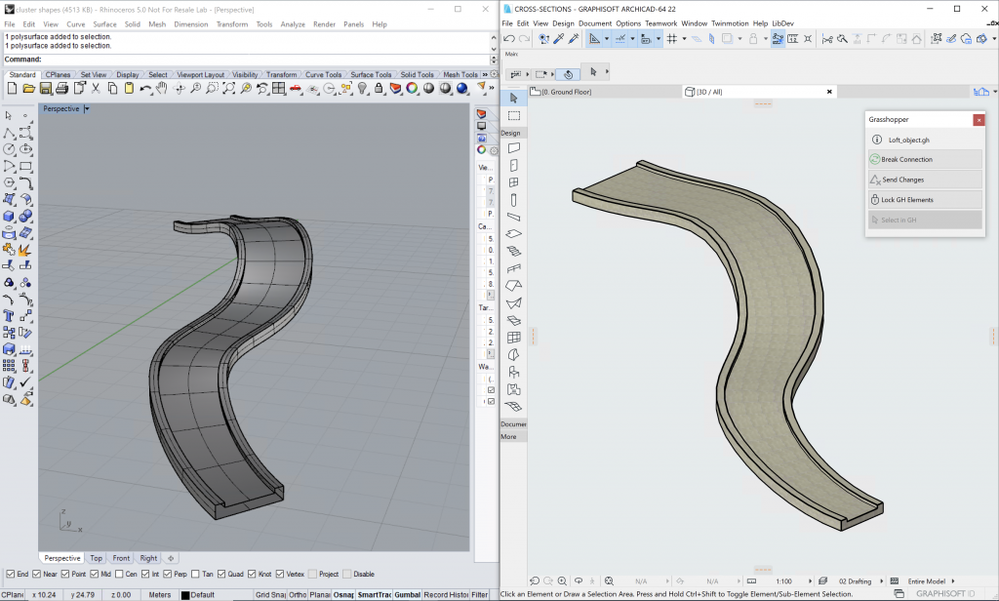

  2. Connect the Object Settings and the Anchor Point to an ARCHICAD Object component, and see your shape appear inside ARCHICAD.
