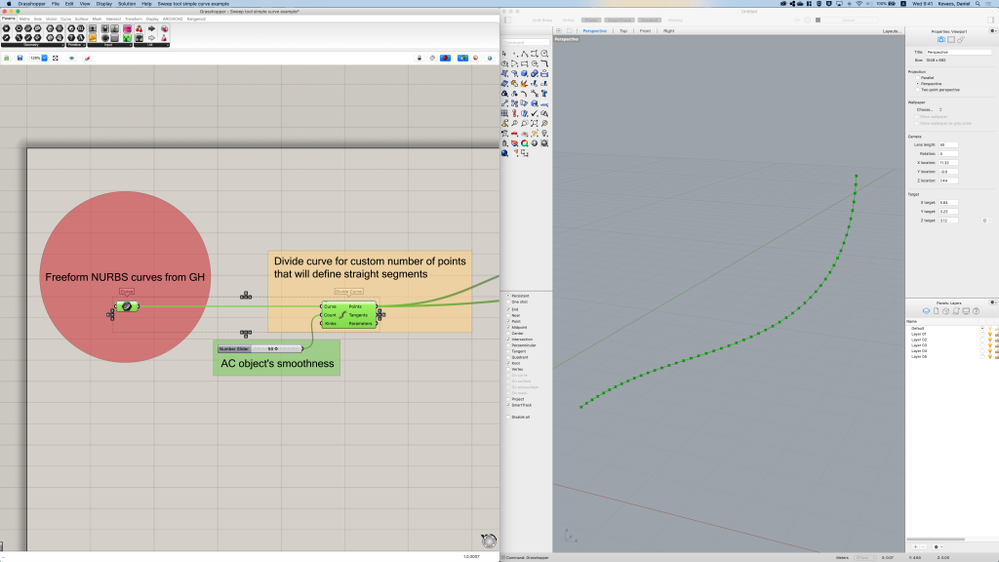

  2. Create a single continuous Curve Component in Grasshopper to define the path of the sweeping (along Complex Profile Axis).
  3. Break down the Curve into 3D points. In this example we use the divide curve component to do this, so later we can adjust the smoothness of the segments.

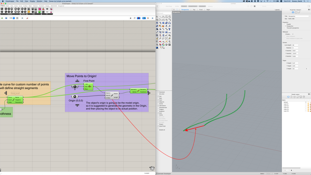

  1. When you generate an object through the connection tool in Archicad, it will always take the Rhino Model origin as the origin for the object. To avoid creating objects that have their geometry far away from their actual origin, it is suggested to generate the object geometry right in the Rhino Origin, and then place the object in its original position after. To do this we picked the first point of the object as the insertion point and moved every point into the origin relative to this point.

  4. The Object can only take a list of numbers (one-dimensional array), so you can't input the points directly. You will need to flatten and convert the points (of the path) to a list of numbers. We are using the "Points to numbers" component to do this in this example. Connect this list to the XYZ coordinates of the path Parameter.
  1. Since the geometry was generated in the Rhino Origin, the Anchor Point of the object will need to be set to the first point of the path once more (just like when you moved it to the Origin).

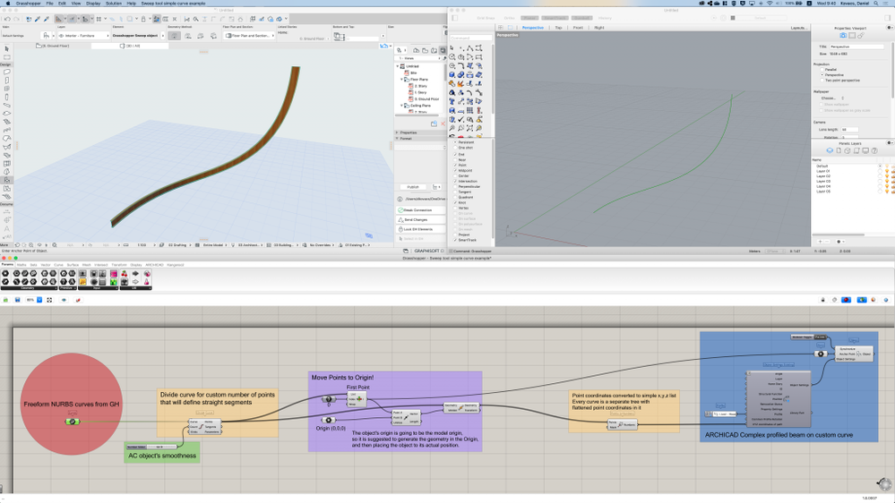

  2. Place a Profile Component, and choose the complex profile you want to extrude/sweep along this path. Connect this to the Profile Input of the Object Settings Component.
  3. Connect the Object Settings and the Anchor Point to an Archicad Object component, and see your shape appear inside Archicad.
Overview of the whole Grasshopper code
