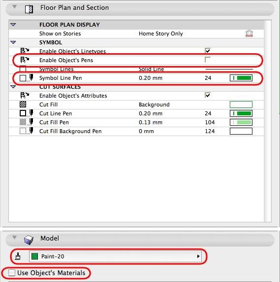

Perhaps the Floor Plan Display or Model settings are doing this (see the attached images). You can override the pen/material defined by the object to force the setting of your choice. Perhaps the object tool settings are set to override the object with a green pen or material?

IN 3D IT happens to all the libraries that i have even with the internal.

Can you confirm that Use Object's Materials is checked under the Model tab in the Object Settings dialog?

Thanks a lot it worked
