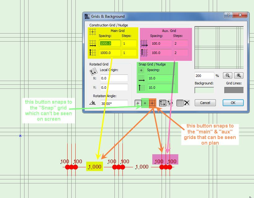

Sarahric,
Be careful that you are not getting your grids mixed up.
There are 3 grids.
The "main" and "aux" grids that can be seen on plan and can be snapped to with the 3rd of the snap buttons.
Turn the snap off, select your objects and drag from a known point, then turn the main grid snap on and it will snap that point to the main or aux grids.
Note the aux grid pushes the main grid apart - it does not sit within the main grid.
So effectively you could use it for brick construction i.e. 300mm brick, 10mm joint.
The third grid is the "snap" grid that can't be seen on plan.
It is simply a movement (or nudge) grid.
Turn the snap off, slect your object and drag from a known point, turn on the snap grid and it will move in increments of this snap grid from the point you commenced to drag from. It will not tie in with the main/aux grids unless the object was on those grids to begin with.
There are 3 grids.

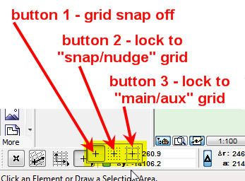

Thanks for the information, but I'm a little confused -"can be snapped to with the 3rd of the snap buttons."? Which 3rd button? Is this the "grid snap"

The attached image is what I mean by the 3rd button.
If you have detail drawings that are "off grid" then the first thing would be to move them back on.
Turn off the grid snap, select your objects and drag from the point you want on grid.
Turn on the "main" grid snap (3rd button) an drag to a grid point.
Of course this assumes all other elements of you detail are drawn to sizizes and spaceings that suit the grid.
If not you will have to repaet the above for each element that is not on the grid.
You should find you can now move elements with the "snap" grid (2nd button) and they will move by the units you have set in the grid settings.
But if they are not on the main grid points then they will not snap to the main grid point.
Remeber you are using the "snap" grid and this has nothing to do with the main grid.
