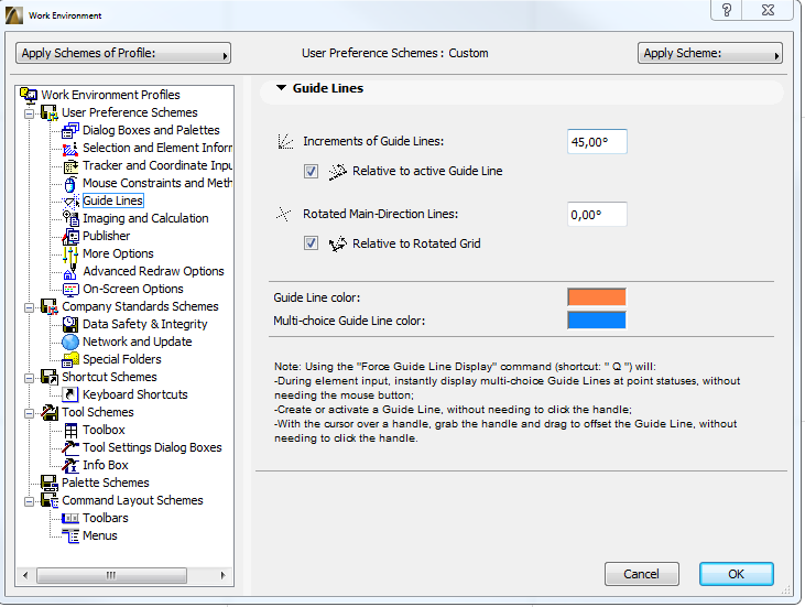

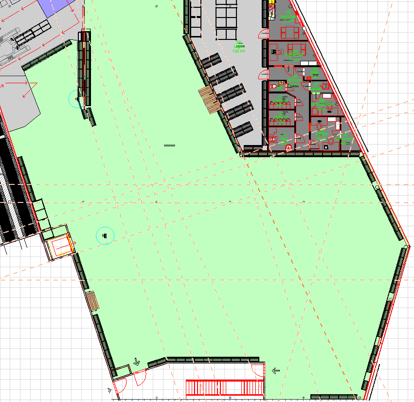

2014-09-03 01:51 PM
I need all the poosible guidelines to show.
No I onely get one 45 angle guide line. before I use to get the X and Y + a lot of other good stuff like paralles and so one.
What am I doing wrong?

2014-09-03 02:09 PM
You have to activate the guidelines and then select the one you want.
Here is one post I found that talks about the 'new' method.
Also look in the reference manual and on-line help.
