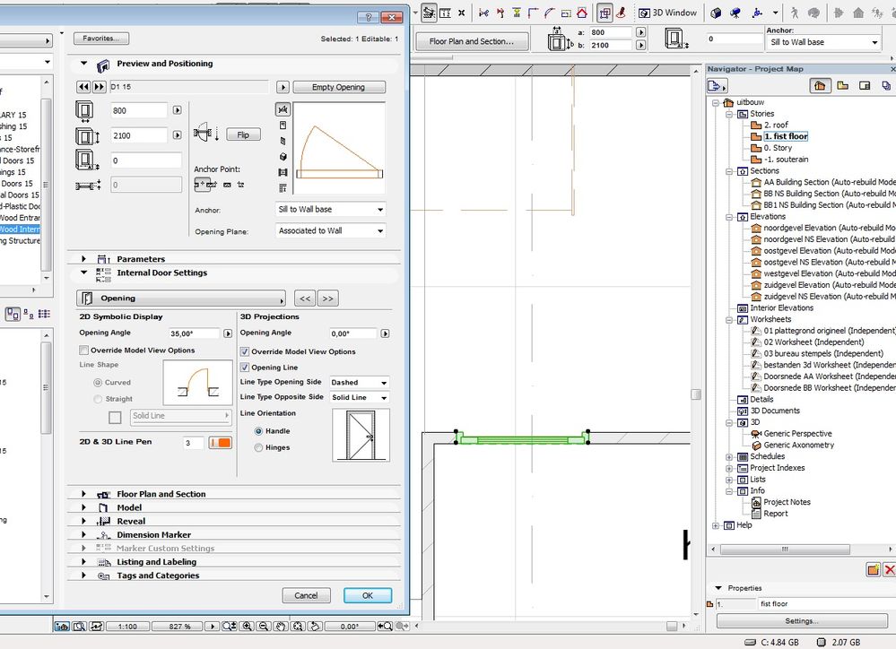

I have a problem with the opening lines from my doors not showing. Its killing me because i cant find the solution.
At door selection settings every setting is oke. Opening angle, solid line, line color etc. etc. But its not projected in my drawings.
Also i checked 2d presentation and all the settings are correct. It even show a opening line at the preview and positioning box (right top corner).
When i start a new template, the settings work correctly. Just not in the file im working on atm.
Please help!
Best regards

One thing to check is Door Settings > Floor Plan and Section > Floor Plan Display > Floor Plan Display > Symbolic. It looks like the door is not set to Symbolic, so the 3D Model of the door is being cut through in plan (using the Floor Plan Cut Plane).
David
David Maudlin / Architect
www.davidmaudlin.com
Digital Architecture
Thank you master David. Your solution worked!
