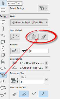

I cannot select Handrail icon when I draw stairs.  Other icons turn blue when I click on them but I cannot select Handrail one when I want to draw handrail and stairs at the same time.  I would appreciate if somebody could help.

Are you running Windows 11 by chance?
Looks like the button a bit darker is actually indeed selected. GS mentioned it somewhere that with Win 11 there are some issues with how decorations are drawn, and until they do an update the selected state of a button is sadly not really well distinguishable.

You mean these ones in the stair settings (info box)?
Yes!
I am not sure what would make those buttons un-selectable.
No matter what I try, I can still select either or both of them.
Thanks, Barry.  Mine doesn't let me select the buttons somehow.  I'm not sure what the issue is.

So that's what I'm trying to do.  I want to place new stairs with the handrails, not on the existing stairs.  After clicking the stair button, I would click on those rail buttons that you shared on the first feedback, but those won't turn blue and I can only draw stairs without rails.
