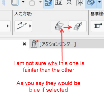

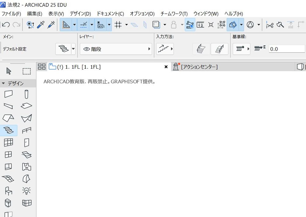

I am using Archicad 25 Education on a windows PC.  Here is what I see on my screen.  The rails are not completely greyed out but they won't turn blue. And the stair direction does work.

Thanks for the image.
I am really at a loss.
I can't understand why one of the buttons is fainter than the other.
Neither is selected otherwise they would be blue as you mentioned before.

runxel
Are you running Windows 11 by chance?
Looks like the button a bit darker is actually indeed selected. GS mentioned it somewhere that with Win 11 there are some issues with how decorations are drawn, and until they do an update the selected state of a button is sadly not really well distinguishable.
73feller
Wow, yes, I am running Windows 11.  I'll wait for the update.  Thank you so much.
