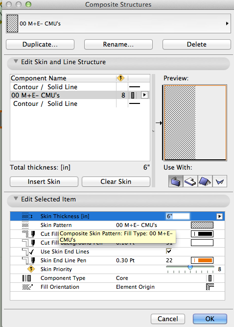

Instead of a regular Fill use a Composite with Fill Orientation set to Element Origin.
It will rotate with the views automatically and it will show in section correctly,
