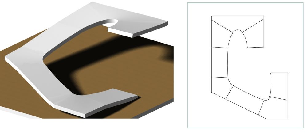

You could try modelling this with OBJECTiVE. The attached image roughly models what you want, with a steadily rising curve on the inside and straight edges on the outside. The rising curved roof is a rising profile bent to a curve, and the OBJECTiVE Split tool was used to cut the straight edges.
