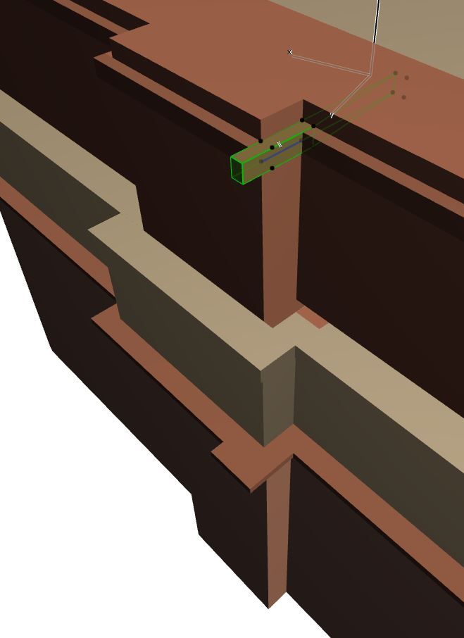

I'm working on a facade, and I'm making it all with wall
The problem is that they seem to intersect well in one direction and when they intersect in the other way the program automatically extends the wall.
I've checked the priority settings and I can't finde the problem.
I attach an image where you can see.
Thanks you very much.

Could one wall be slightly lower or higher than the others ?

Sometimes I have been able to solve this by selecting one Wall and changing its Junction Order.

This my standard method to model the facades.
I put all the elements of the facade on a layer with a different intersection number so that the walls used to model cladding and the wall of the building enclosure don't connect each other.

I had a similar problem when trying to create a vertical interlock with the base of one complex profile passing below the top of another complex profile.
