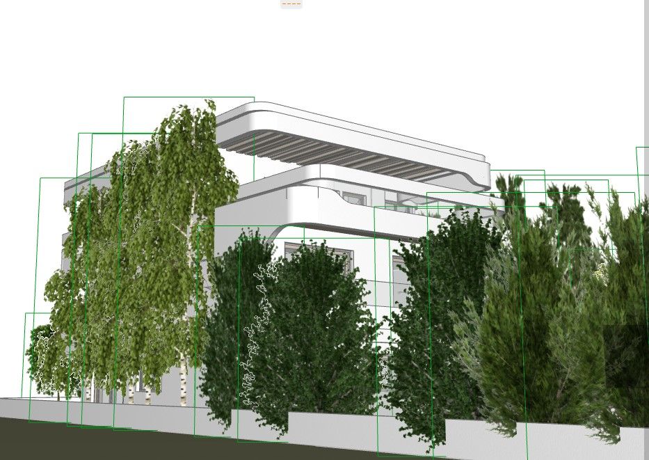

Hi! Thank you for your reply! How do you select the items to exclude? (without new layer combinations). In my case it's certain trees that I don't want to be visible in one of the cameras I've set up but visible in other cameras..

Hello! Thanks for the idea, I will try it! I'm trying to hide certain trees from some cameras but I want them visible in other ones. I posted a picture above.

You don't select the items you want to exclude.
You select the items (in 3D) that you want to show then 'Show selection in 3D' to hide those bits you have not selected.
So basically in open a 3D window that shows everything.
Then 'select all' and start to de-select what you don't want to see.
Now 'Show selected in 3D' and those bits you didn't select will be hidden.
Now you update or save you 3D view.
That is the old way.
In 25 you can now select what you want to hide, right mouse click and 'hide selection' - much easier.
Then again save or update your 3D view.
The view will remember what you had showing next time you open it.

To this it should be noted that you don't hide the selection but show the inverse of the selection with the effect that nothing added to the model after the View is saved will be shown. So if you add something that you want shown in the View you have to reset by Show All, redo the Hide Selection and Redefine.
