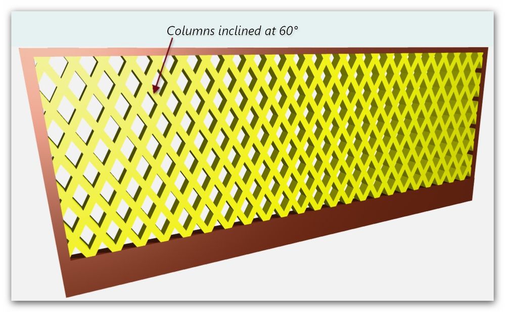

I need to build a "honeycomb" wall, but have no idea how to build it in ArchiCad. The attach render has been made in Revit.

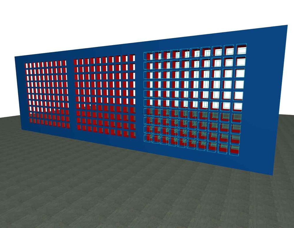

Something like this?
I use only columns and walls with some SEO's on the ends.
Just to be clear...
These openings are made with three beams automatically punching through the one wall. The nearest beam is shown in wireframe. Of course the same effect could be accomplished with a single profiled beam or arrays of simple ones. I have used squares for speed and simplicity. The shapes could be just about anything.
Of course after all this about beams and auto-intersection, there may be performance advantages to the SEOs. I haven't tested this.
