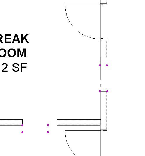

After installing the hotfix on PC build 815 I now I get wierd behavior of empty doors. Maybe there is some larger issue here, and maybe ot was around before the hotfix, but no one in this office seemed to notice it until today when I installed the hotfix.
Basically the hotspots for an empty door appear in fairly crazy places and have strange behavior. The screenshot shows where the hotspots appear around an empty door. If I flip the doors, the hotspots line up with the edges as they should but the lower of the two in this screenshot still float outside the jamb of the empty door. Wierder than that, I can still click on the jamb and stretch the empty door, even if I am not clicking on a hotspot. The hotspots that appear in the wrong place only allow me to move the door, not resize it.
I can work around this problem, but it is still a little discerning to think that a hotFIX broke something so simple at the same time.
