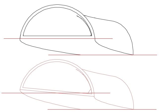

How can I model this using the shell tool?
I need a roof, barrel shaped, curved aling its horizontal axis and slanted along its long axis.
I created this shape using a wall profile, but I cannot elevate one end (even using Objective).
I know we can elevate shells, but I cannot get a horizontal curve.
Any thoughts or ideas will be of immense help.
Thanks.

Barry wrote:
Single curved profile rotated shell that was free rotated in 3D.
Doesn't a simple rotation also tilt the profile as it turns about the curve? The attached image shows 2 different methods (view end of at the end of the curve). The lower object was created with a simple free rotation - the profile is level at the start, but is progressively tilted as it turns through the curve.
Ralph Wessel BArch
Central Innovation
Extruded shell - curved using rotated shell:
