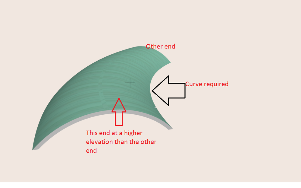

How can I model this using the shell tool?
I need a roof, barrel shaped, curved aling its horizontal axis and slanted along its long axis.
I created this shape using a wall profile, but I cannot elevate one end (even using Objective).
I know we can elevate shells, but I cannot get a horizontal curve.
Any thoughts or ideas will be of immense help.
Thanks.

Do it out of several Shells (Extruded Shells if the profile polygons at the two ends are the same size, Ruled Shells it they are different). You can either adjust the Starting or End Angles for the Extruded Shells or you can define contours so each segment has the top contour you need and join properly to adjoining segments.

If the profile at each end is the same and the long curve is constant then this could be done as a rotated shell.
The rotation point is the centre of the long axis.
All one piece and then you can free rotate in 3D to get the slope you want.
But if the end profiles are different or the long curve is not uniform then you are back to joining segments.

OBJECTiVE cannot manipulate standard ArchiCAD elements like walls and slabs because their properties are set by Graphisoft and cannot be extended. Only GDL objects have this capability, and consequently that is the primary focus of OBJECTiVE.
To produce your rising barrel vault, do the following (referring to the attached image):
  • 1. First we need to create an object with the required shape. Draw a cross section through the vault using the Fill tool (you can copy/paste and item from the Profile Manager palette too).
    2. Select the Fill, and click the menu OBJECTiVE > Component > New Profile.
    3. In the New Profile dialog, specify that the selected fill is a Section, enter a name for the new shape object, and select a library to store the object in (Embedded is usually a good choice). Click OK, and then click on the anchor point for the shape (the position that remains constant if the shape changes - the centre of the vault is a good anchor for this shape)
    4. Select the new shape object in the OBJECTiVE Tool Settings.
    5. Set the Geometry Method to placement by length and angle.
    6. Click on the start and end positions of the vaulted roof.
    7. Select the newly placed roof and click the menu OBJECTiVE > Tools > Bend to bend it to the required curve in plan.
    8. Then view the vault in elevation, select it, and click the menu OBJECTiVE > Tools > Offset to raise the end of the vault to the required height.
    9. The finished shape in 3D

@Barry: thanks for the suggestion; I tried it but the horizonal curve gets mirrored giving me a narrow profile in the middle.
@Ralph: thanks for your time; your solution has worked and I am happy that my investment in Objective got justified. Excellent support.
@Laszlonagy: thanks for the links.
Single curved profile rotated shell that was free rotated in 3D.
