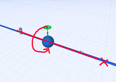

I installed the new version of ArchiCAD 29, including MEP Designer, and I couldn't rotate the valves in either version.....
Is it possible or not?

It seems to be reading that value from the pipe.
In a horizontal pipe it is 0° (with options available - but it won't change).
In a vertical pipe it is 90° (with no other options - but it still won't change if you type another angle).

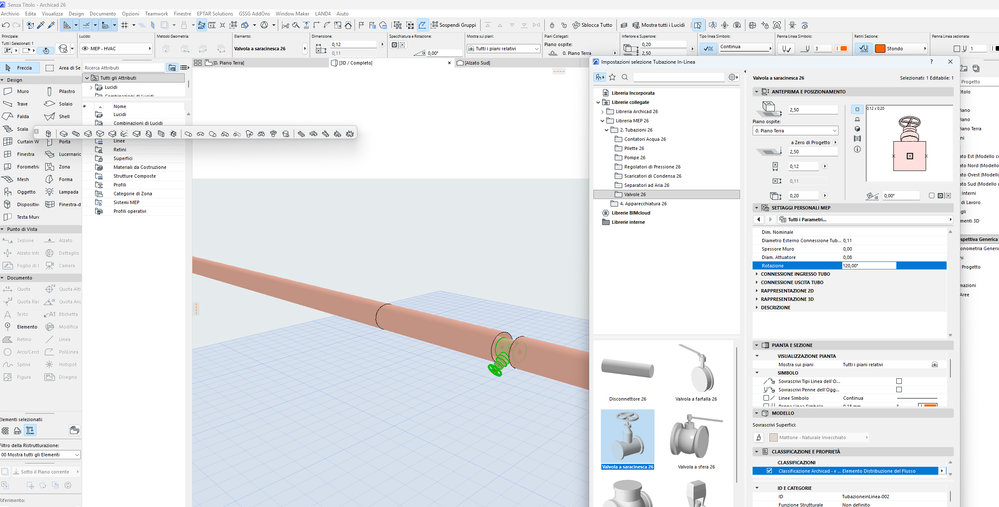

If you select the valve settings before you place it. this rotation angle is greyed out.
That makes me think it is getting the value from the pipe.
I see no way to rotate the pipe though (around it cross section).

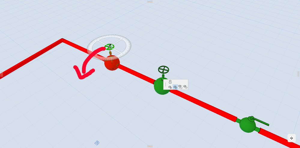

I still think it's a bug, or at least that even after three versions, the MEP elements haven't been fully adapted to the new MEP 2.0 system, keep in mind that with the old MEP, this parameter worked perfectly with the option to choose rotation around the tube's axis.

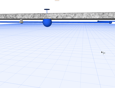

The valve can't be rotated around the pipe axis... This is a nuisance because if you have to place the pipe under a slab or ceiling, the valve should be positioned at 180°, otherwise, the valve will collide.

This worked "fine" in the preview; it was the first thing I tried...now it's disappointing that it was in the release. It was manual, but at least you could. What did they do?...  😩🤡

rethat’s what I do…then save it as an object in needed regularly. Another option is to bring it into modelport and make adjustments there.
Save it as an mep part, not object.
But you would need to script it as a MEP part if you want all of the MEP functionality.
That is a good work around for those that use modelport. Or save it as a MEP part as you suggested below.
