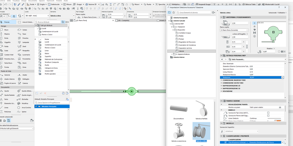

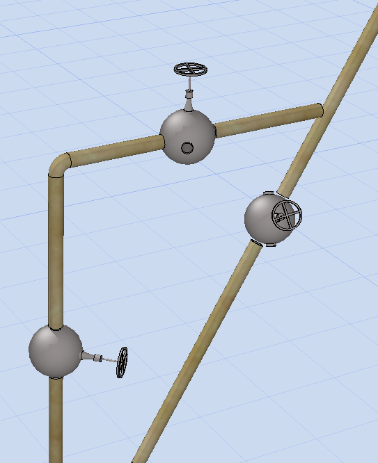

I installed the new version of ArchiCAD 29, including MEP Designer, and I couldn't rotate the valves in either version.....
Is it possible or not?

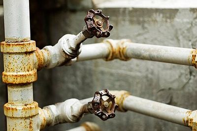

for Barry: he is probably trying to achieve the former. When pipes are mounted on a wall, the valves are turned towards the user.
this is the Wikipedia picture for valve. This is probably what he s trying to achieve.
 To try to answer the question, probably you need to create a duplicate of the valve object and add your own custom functionality to it.

For some reason I completely missed the red arrow indicating that the whole valve needed to be rotated vertically.
I was looking at it as rotating just the valve handle.
As the valve is an object, it appears that it can only be rotated in the horizontal plane.
No matter what angle the pipe is at (horizontal, vertical or sloping), the valve will only rotate horizontally.
I don't see any options in the valve to rotate any other way.

Hello @lopezfigueroa, it seems to me a bug, infact if you choose the rotation inside object parameter window, the rotation is permitted at at pre-established angles(0°,90°,180° and 270°), and also the preview reflect this modification, but if you click ok nothing changes.....
probably someone at GS could give us more information about this
