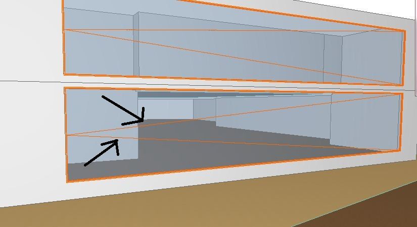

How can i remove symbols on windows in 3d ?
Hello every one
I have a question maybe it is easy but i do not know how to handle it?
How i can remove the symbol of two line on window as in the image and make it not apparent when i click show 3d window
Thnaks

Select ALL Windows and set to OFF:
the problem that the type i am using does not have option you show look at the image i attach if there is any way ?? i do not also want slide window
Change Model View Options:
And then set the Window:
