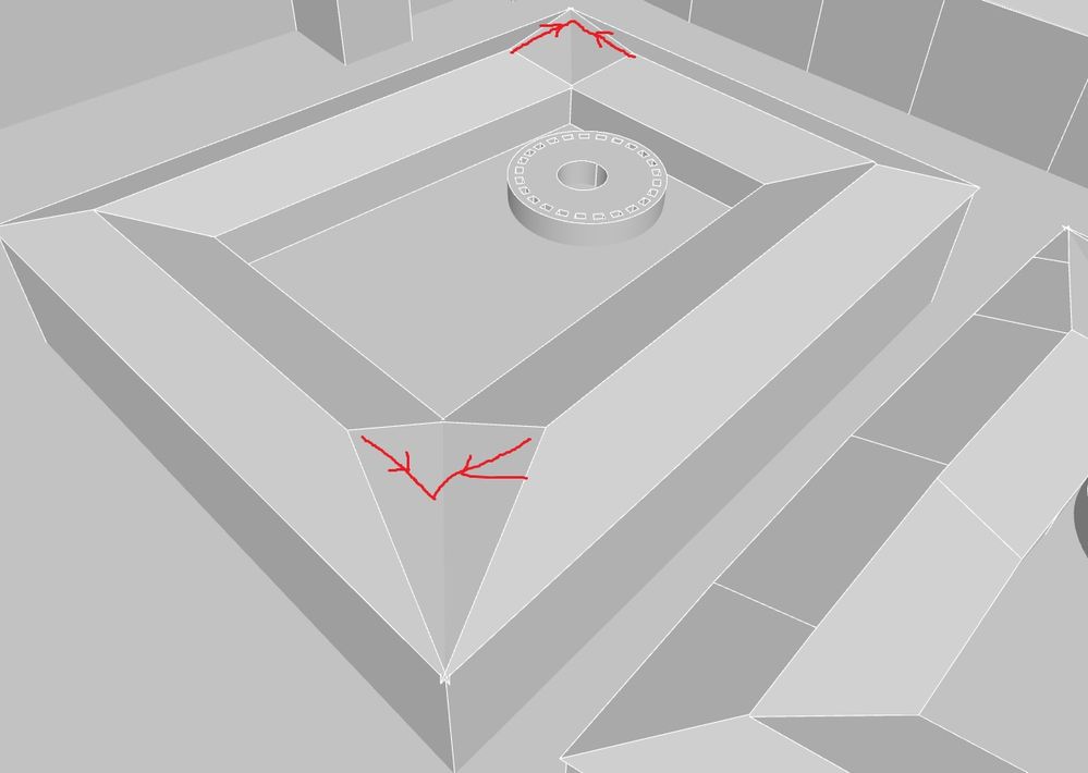

How do I join my roofs ?
I have this big square biulding but with a large courtyard in the middle.
I want to create a normal roof that follows all around the building.
please see the photo attached showing what i am talking about.
how can i do this ?
thanks guys.
Ian

In AC15 here is how to create this atrium:
http://www.youtube.com/watch?v=XTY-zJuEtH0

but.... i can create the complex roof.
i can click on the outside line, get the pet pallet and cut a square out.
but i cant click another line on my roof, also get the pet pallet and make a cut. so.... i get a correct atrium shaped roof ?
what blond thing am i doing wrong ?
thanks.
Ian
I think you should click the Pivot Line polygon, not the outline of the Roof.
2x28" (2560x1440), Windows 10 PRO ENG, Ac20-Ac27
how do i find that ?
i clicked on every line i could see and the only line to give me the pet pallet ws the outside line ?
Ian
Are Roof Pivot Lines shown?
Make sure the View\On-Screen View Options\Roof Pivot Lines menu option is ON.
Plus, you need to use the Subtract from Polygon command of the Pet Palette.
