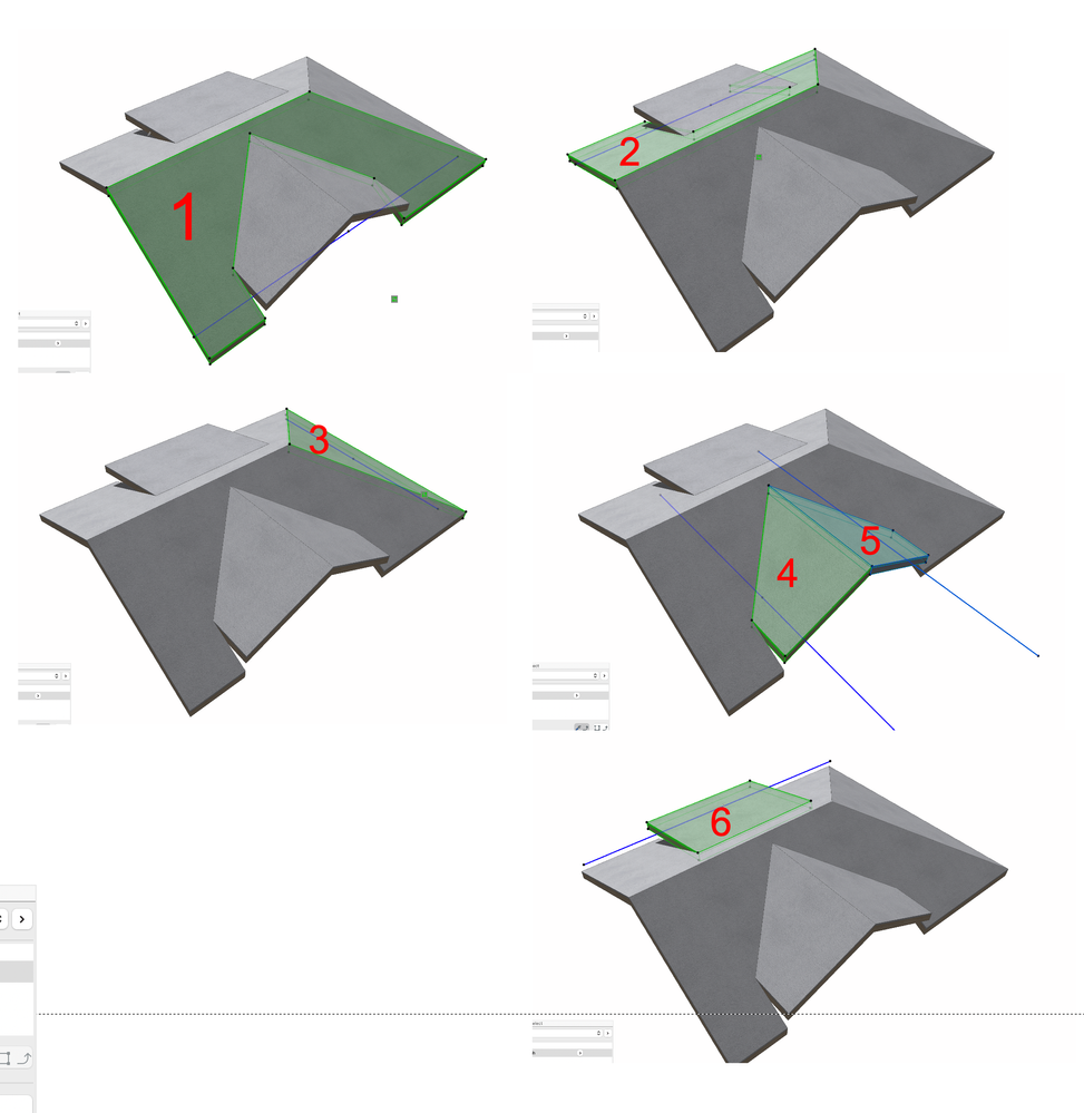

Patrick M
Mentor
I'd use about 6 individual roofs for the roof you have pictured in the morph. You could start with a multi-plane roof, but you would want to split them off pretty quickly in order to get the shed and gable (or hip) dormers cut in. Com+click will trim roof edges to each other.Screen Shot 2023-01-02 at 4.48.19 PM.png
