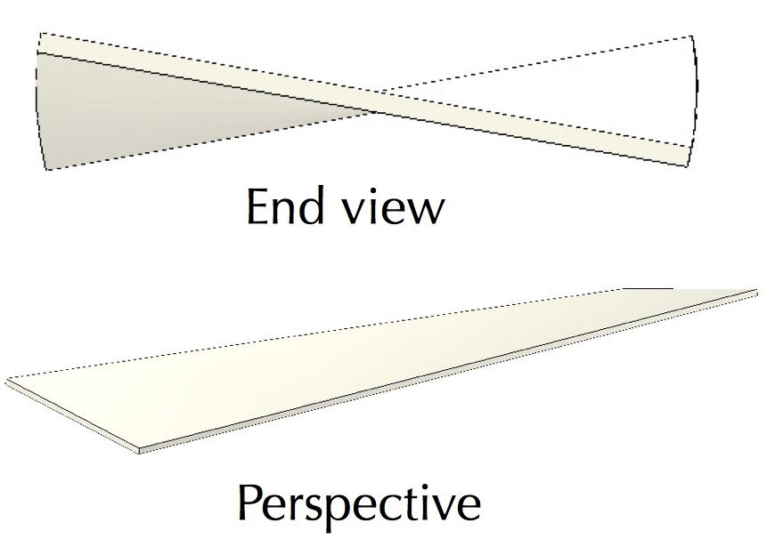

The latest version of OBJECTiVE (but not released yet) has new properties for profiled objects to twist them around a specified angle - an example image is attached showing a rectangular cross-section twisted through 20 degrees along its length. I can send a beta version to you if you want to try this.

this OBJECTIVE tool should come STANDARD in Archicad.......thanks again Ralph and all.
Attched a quick test
