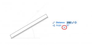

What is displayed in the Tracker
By default the Tracker shows the 'Distance' and 'Angle'. X, Y and Z coordinates are hidden, they are shown after the Tracker is expanded. The Tracker can be expanded using the little arrow on the Tracker (appears after pressing 'Tab') or by using the 'Arrow Down' or 'Tab' button.
Activate the 'Expand Tracker Automatically option'  in Options/Work Environment /Tracker and Coordinate Input, then all the parameters will be shown as soon as you enter the Tracker. To switch between DA (Distance/Angle) and XY coordinates on the fly, press '/' (slash character) button. Units can be changed in the Options/Project Preferences/Working Units.

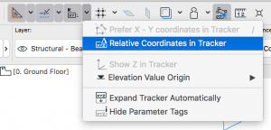

Want to measure the distance from a given point
  • Place a User Origin
  • Turn off 'Relative Coordinates in Tracker' at the Tracker Toogle
or
  • Place a Snap Guide
    • Hover over the existing Snap Reference until it disappears, or click Q
  • Enter your values into the Tracker
