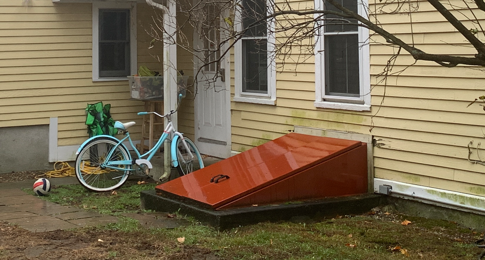

Has anyone modeled an exterior basement bulkhead hatch like the one in the attached photo? If so, what's the most efficient modeling method?

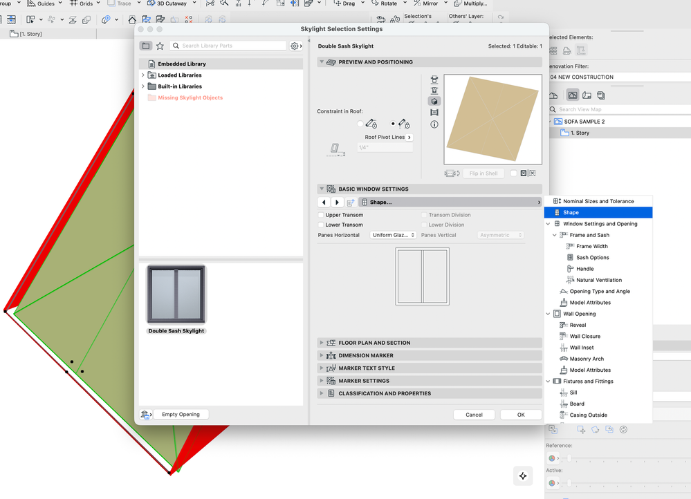

here's a kind of fun option:
-place any window or door type you want to use for a sloping hatch
-select the placed door, go to file > libraries and objects > open object
-change the subtype to skylight

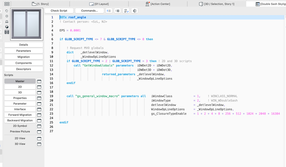

-in the master script, add a line at the top: rotx roof_angle (this will match the slope of the roof used for the hatch top)

-model the hatch with walls, beams, etc... use a roof for the hatch lid and place your 'custom' skylight for the opening. since it's using the door or window macros, you should have access to all the leaf/sash/hardware options!
