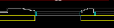

How to build a sloping wall like that?
1. elevation
2. plan
AC27 on window 11

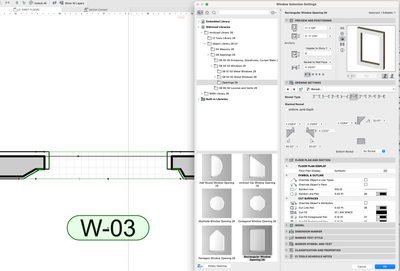

Patrick M
something like this:
Patrick M
you can get the same opening on some windows, or you can just model them as 2 separeate windows; one for the unit, the other for the wall hole

1. Don’t I need to separate the wall for this type of wall?
2. I think the key is how to connect the finished wall to the inwardly slanted lower part.

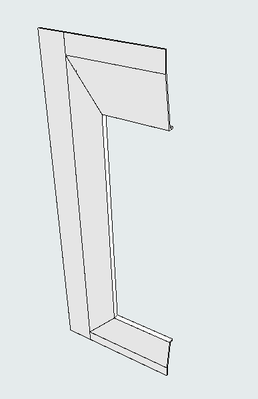

LeeJaeYoung
Shouldn’t the finished wall and the structural wall be separated?
How should I build the wall?
The walls from the left and right and the walls from the top and bottom must be connected like this.
What should I use for the walls at the top and bottom to connect them like that?
AC27 on window 11
