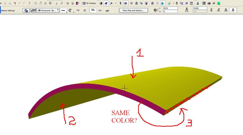

Hi, I have a problem with complex profile walls. I've made a curved roof from a wall, but i don't know how to change its materials. I need 1, 2 and 3 colors to be different materials. Thanks.
i use AC11.

The end material is controlled by the element (Wall, Beam, Column) material. The material of the extruded faces are controlled in the Complex Profile Manager dialog.

Erika Epstein
In the window where you created your custom profile, select a fill
Place your cursor so you get the mercedes cursor on a side and click on the last icon in the upper right of the pet pallet. This will open the Custom edge Settings box. Note that you can apply this material, line and pen to one or all of the fill's edges.
