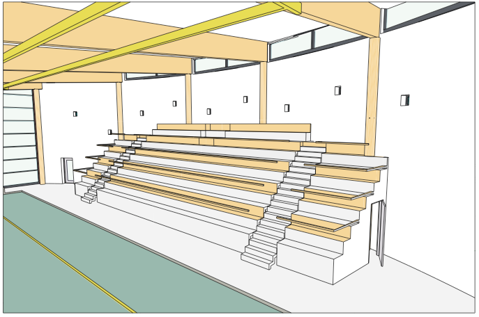

Still this is an extremely powerful tool. A humble example is this gallery (pic attached). It's entirely made out of three slightly different complex profile walls, nicely joining with ordinary flat walls at the ends. No SEOs or other tricks, and still the (crude, I know) railings actually work!
And until they fix the 3D profile end material problem (I'm sure they will eventually, but just like some other common wishes it may need a better 3D engine in Archicad, and thus take a couple of versions yet) there are workarounds. Do a search in this forum and you'll find lots of better examples!
