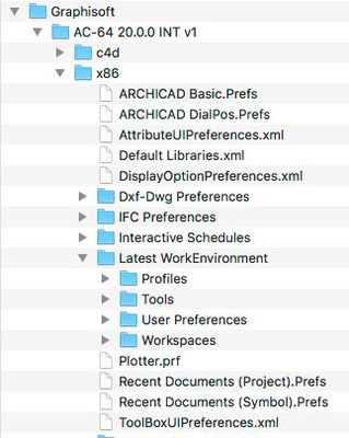

I can confirm that this also seems to be the case on the Mac, although different location. For an installation of Solo, this file can be found in...
/Users/<UserName>/Library/Preferences/Graphisoft/AC-64 20.0.0 UKI v1 SOLO/x86

Quite the same in the Mac. Begin by accessing the Library/Preferences folder holding down the option key while using the Finder "Go To Folder" command. Enter ~/Library/Preferences. You can also refer to the following link: https://discussions.apple.com/thread/5056256?start=0&tstart=0
