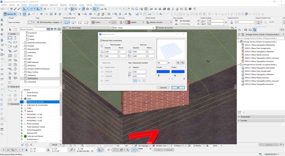

Today download the error file. I opened it in archicad 27. I opened the coordinates palette and double-clicked on the user origin.
Check the grid and background data and the origin was set to 0.
Export to google earth and the error was corrected.
