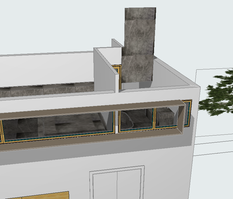

I have this little window awning that I want to be able to change with the width of the windoCapturesdfdsfdfg.PNGws. Is there a way to do this parametrically so I don't have change it everytime I change the window size?

I don't think a stretchable box is the real problem here.
That would be quite easy to do.
The problem here is the original poster wants it to span around 3 or 4 windows and have it adjust as those window sizes are changed.
that would be a challenge.

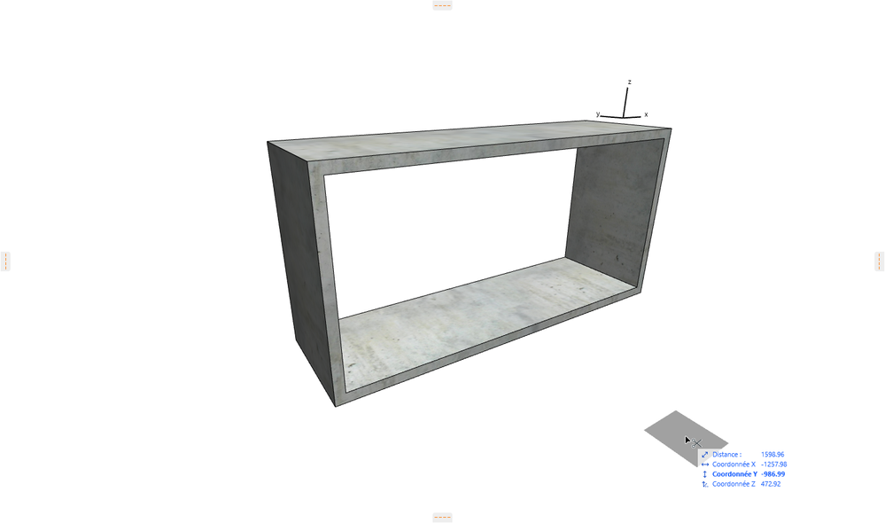

using gemini , i created this code, it works well , just change the building material name :
! --- Dimensions & Settings ---
! A = Overall Width (System Parameter)
! B = Overall Height (System Parameter)
thickness = 0.05
depth = 0.60
! --- Surface / Building Material ---
building_material "Concrete"
! --- Orientation ---
rotx 90
! --- Parametric Box Construction ---
prism_ 10, depth,
    ! Outer boundary (using A and B)
    0, 0, 15,
    A, 0, 15,
    A, B, 15,
    0, B, 15,
    0, 0, -1,
    ! Inner boundary (subtraction)
    thickness, thickness, 15,
    A - thickness, thickness, 15,
    A - thickness, B - thickness, 15,
    thickness, thickness, -1
then , you can call this code in the window object at he top level , the code uses A and B variables from the window to follow it's dimensions.
PS : i'm a GDL Newbie , i don't code , but , whith AI i created a dozen of great working gdl objects for my daily wor k ,just by describing what i need to geminy , and add instructions step by step , ex : create the shape, add parametricity , add hotspots etc

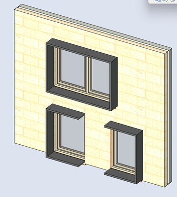

At least the impression that I got from the original image it that it should surround multiple windows.
A single window is relatively easy, I have done that myself.
I guess you could do it per single window with an option to turn the sides off (which is also what I have done for my windows).
Then they can 'link' when placed next to each other.
Unfortunately I can't share this object as it is built in and designed to work specifically with my windows.
It won't work with the Graphisoft windows.
