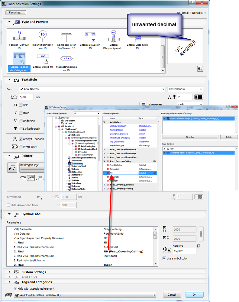

I was pretty content with the custom rule for my Room Height parameter made for sue with Ecophone ceiling objects...however I get an annoing decimal in the label which I can't hide. Any ideas?
Cheers,
Mats

Of course I found it after I posted the question. Calculation Units&Rules. Hopefully it won't mess up something else. I thought Calculation....was solely for calculation...well apparently not.
