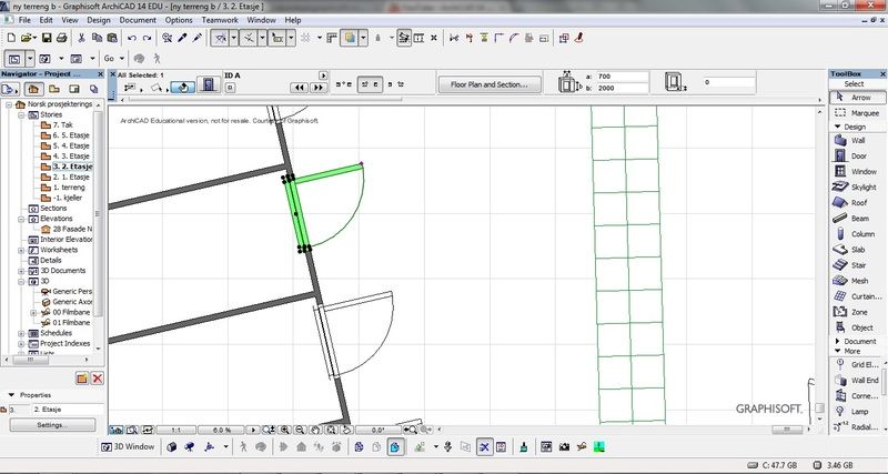

Hei. I have a truble with making my doors fit to my walls tickness in building. Tried alsmost everything but can not find a solution. I really would appreciated if somone could help me.
Thank you and sorry for my english
I use ARCHICAD 14 in windows 7.
1 REPLY 1
There should be a setting for frame width - make it 0 and it will match the wall.
