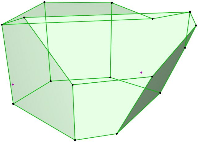

Yosribkd wrote:
Here is the form that i managed to create under 3dsmaax. Is there a way to reproduce it under Archicad 13?
You could try OBJECTiVE. I produced the attached image in about a minute by creating a profiled object (OBJECTiVE > Component > New Profile) and then using OBJECTiVE > Tools > Split to cut it to the required shape.
