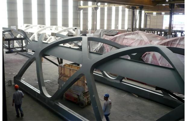

Here's an example rendering of what I'm trying to model:calatrava-calgary-bridge.jpg

Calgary’s Peace Bridge. Cool Bridge. But what a disaster (in terms of construction).
There is noting I see in the picture that could not be modeled with ArchiCAD. There are many ways to do it.

So it is the curved and tilted I-Beams that might give you some trouble.
And how to get the curved glass that fits the openings perfectly. No problem!

Steve, well basicly what complicates us is the modeling of that curved beam and making de rounded glass to fit it, im guessing that giving that glass some kind of spider joint is impossible right?

I will give it a try with words. A beam profile is selected( you will want to make your own as a complex profile) and using the magic wand click on a curve of the radius you need.
Now you have the beam but it is in the regular vertical position. In the 3D Window you can convert that beam to a Morph and rotate it the angle you need and you will have a tilted and curved i-beam. ( Several other ways to do that part)
Mirror that one and you will have tilted intersecting curved i-beams.
The curved glass to fit the hole ( for lack of a better term) is also done many ways. I did it with the Elipsoid 18 object.
Place the Elipsoid in plan view centered top to bottom and right to left with the tilted i-beans. The in section views stretch it to fit the window opening.
like so. http://screencast.com/t/jUQgw3pK
Copy a second ellipsoid down the thickness of the glass. Use it as SEO on the other on. Convert to morph, Split whats left away from the beam and delete. Change to glass. Done. I will show more later but I am on my way to 4th of July picnic.

This is my problem, making the tubular shell folow this path, any idea how that can be done?
