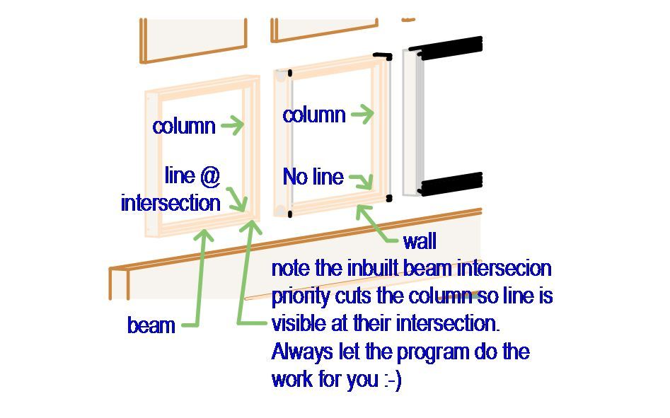

Originally I applied the horiz. custom profiles to the wall. This left no line where they intersect the vert. sides made with the column tool . I changed the walls to beams and the beam's natural cutting section (intersection priority) trimmed columns creating a line where they intersect.
Remember, this is just one way to accomplish this. Challenge yourself by thinking through the pieces from which in real life the coffered arch will be constructed.

The curves are made with walls. In fact it's all made of walls except the columns for the vertical trims in the assembly model (which become the horizontals in the installed door) and the slab for making the wall opening.
There is a limitation to this method though. The walls and columns as panel trims don't clean up quite right at the corners if there are any undercuts in the profile. For example ovolos and ogees work fine but beads and band moldings fill in a bit badly at the corners.
Otherwise the walls and columns clean up nicely and automatically (no need for SEOs).
