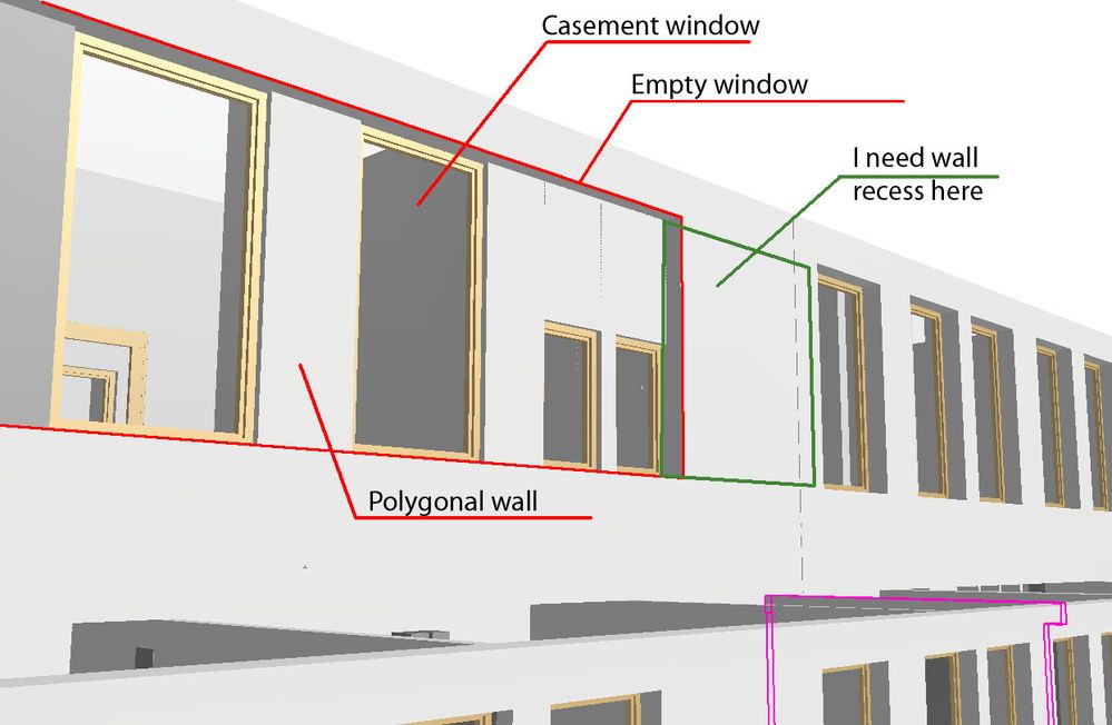

I'm having a problem modelling the following windows and walls.
(see attached image)
I have tried using an empty window to cut the recess and polygonal walls for the pillars between the windows. This still leaves some lines in story views and it's impossible to have a clean model, easy to modify later.
Besides SEO and modelling every wall around the windows (very non-productive) is there any way to solve this?
Thank you

how i modeled so far.

Hi Usinata,
I'd use a "Wall Niche" window...

Ernest Atanasiu
you saved me!
thank you!
i searched for every keyword possible in the library, but niche.

wouldn't a complex profile wall with the recesses already in it be the easiest????
Erika Epstein
I used a complex profile wall for a project but had problems with corner windows. I ended up putting an empty opening in the wall where the wall was set back, and then placing a regular wall the size of the empty opening. Into this regular wall I could easily insert corner windows.
