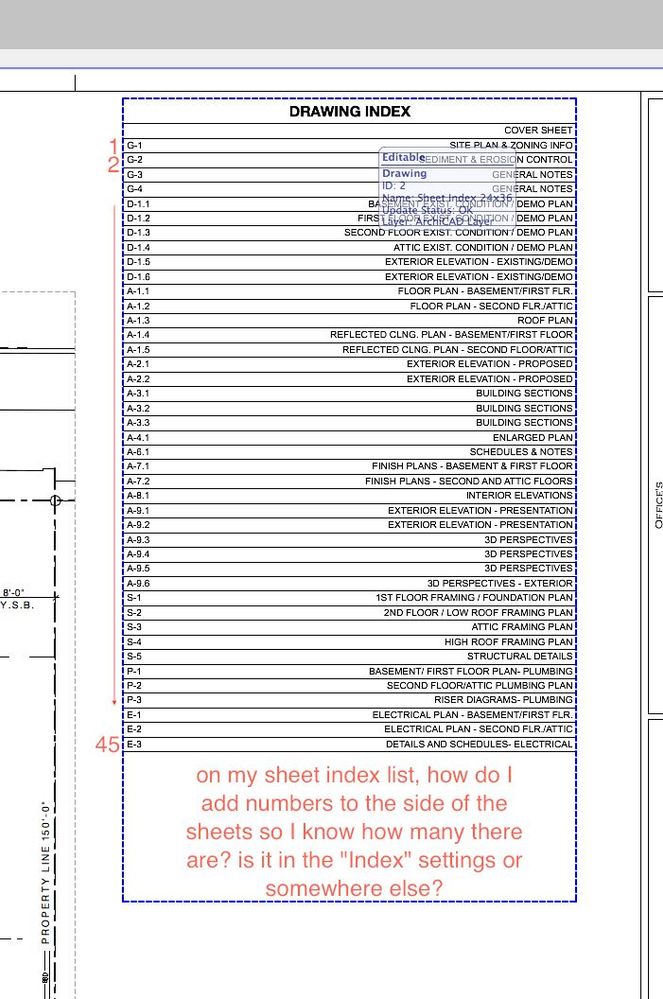

How to number the sheets on the Index List?

Hi Rob,
I don't think you can do it automatically, but you can add in another 'custom text' column, and manually type in the number for each. Make sure you untick the ordering arrow for the other fields in the index settings leaving only the new 'custom text' column ordered.
