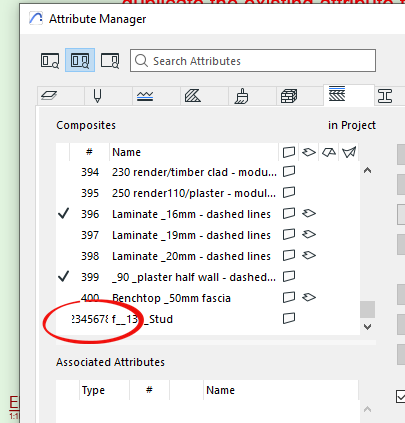

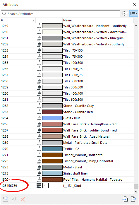

The Attribute Manager will only show up to 6 characters for the index number, although larger numbers will work.
The Attribute Palette is adjustable in width.
There should be no need to go beyond a 6 character index number.
I find 4 characters (up to 9999) is enough for me to organise my attribute groups.

The number can't be super big though as you may not be able to see it in some of the dialogues.
