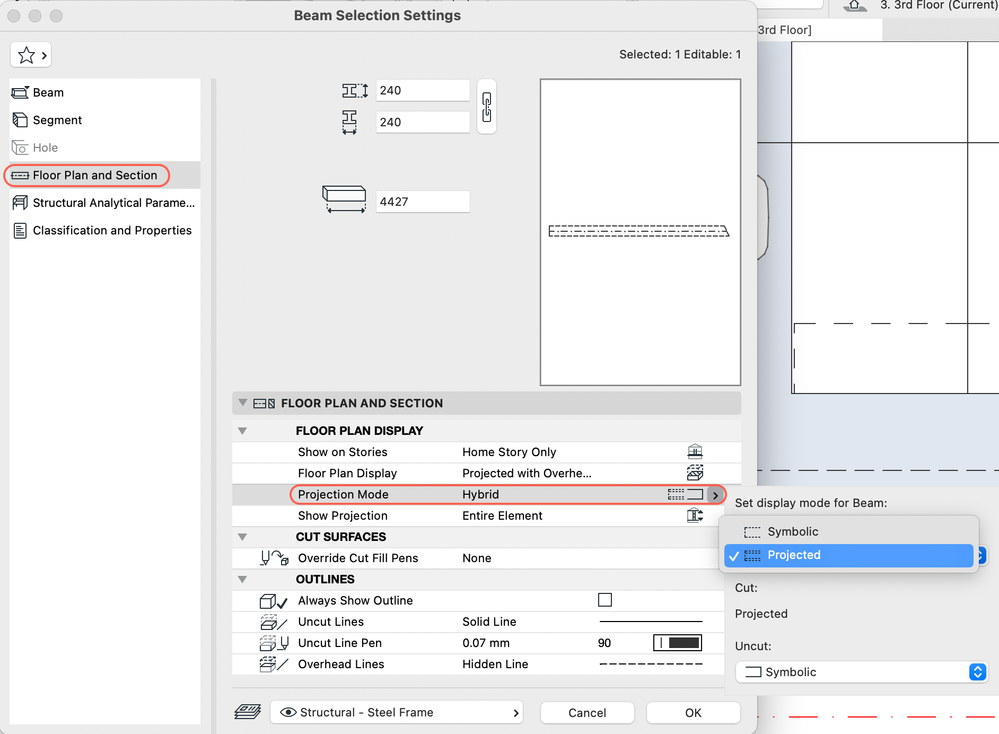

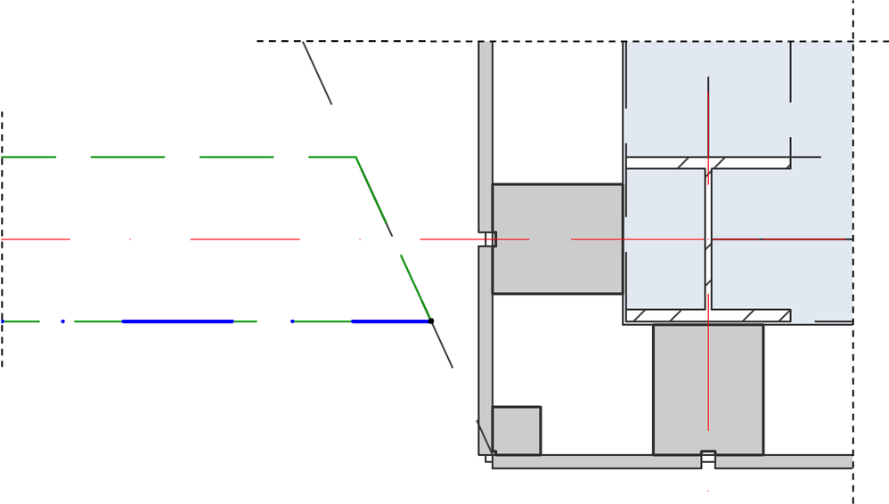

  1. Start by modeling a Beam in a Floor Plan view, then offset the reference line to the edge of the beam.
  2. Set the overhead Projection Mode, under Floor Plan and Section, to “projected”. This setting allows the angled cut at the start or end of the beam to be reviewed in the floor plan view.

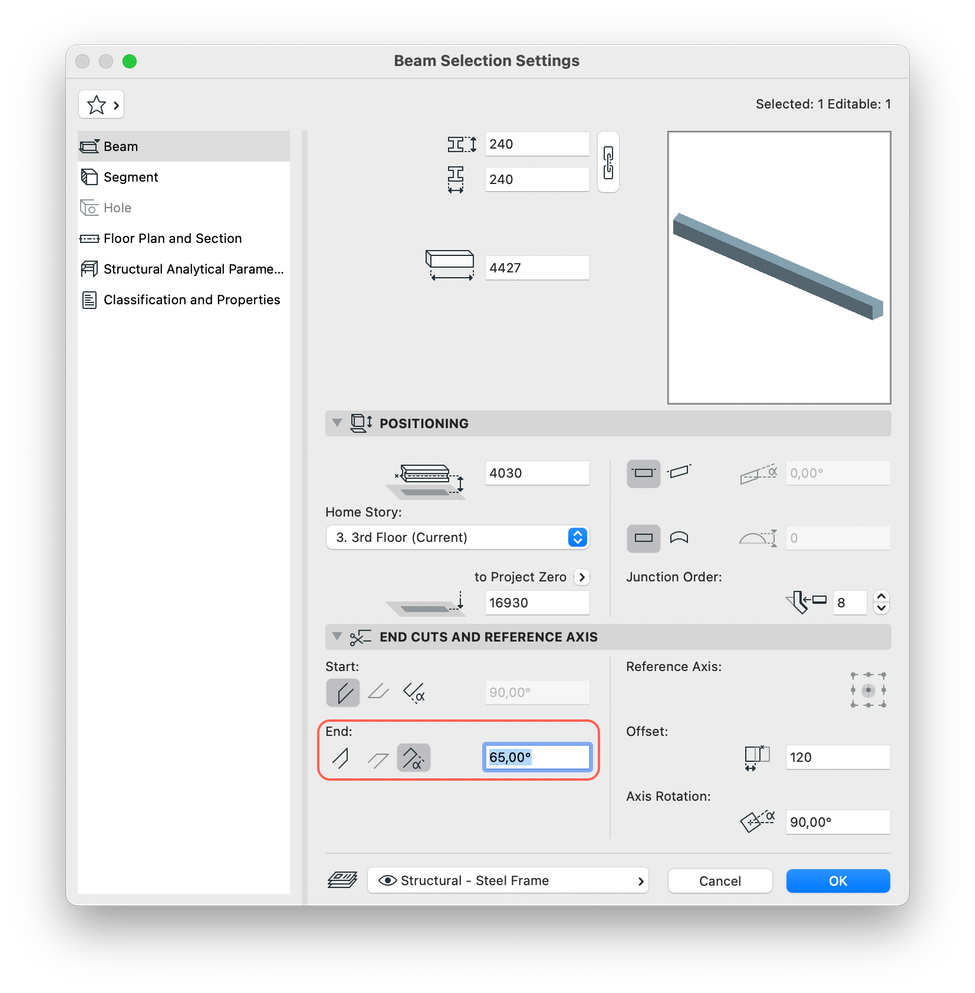

  3. Depending on the plane on which the slanted cut should be visible, keep the beam at a 0‑degree rotation angle or rotate it 90 degrees. The angle of the cut can then be set either in the Beam Selection Settings dialog (Option A) or directly in the Floor Plan or 3D view by using the hotspot at the beam end (Option B).
    OptionAOptionA
             OptionBOptionB
That is all that is required. A beam can be cut on a horizontal plane in the same way as on a vertical plane by rotating the element and applying the desired end cut.
The outcome
By applying this method, beams can be fitted to any angle on either a vertical or horizontal plane while ensuring that their angled ends display correctly in floor plan views. This approach reduces the need for additional detailing and supports clean, professional documentation that accurately reflects the design intent.
