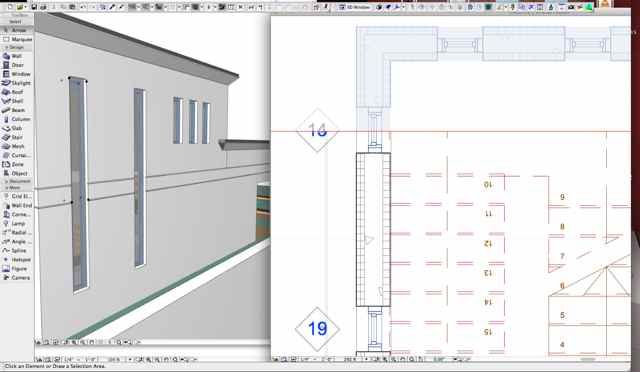

How to put window on two different floors
Hello, I am beginner so this problem may be funny for you guys but I just cant do this.I need windows to put on 2 different floors and I wall is always blocking half of my window.Thanks guys

stefan wrote:
@David: if you use an empty hidden opening, how would the plan display the window that is located on the floor above? That part I don't get.
That advice was for users who don't need or want to see the window on both stories, so not applicable in your case.
stefan wrote:
Can you illustrate what it looks like in plan view on the two different floors? In my example, the ground floor (story 0) displays the empty opening in 2D (with reveal) and not the window frame, as this is only visible on the story above.
You already have the solution to showing the window on both stories:
stefan wrote:
It works better if you have a single wall that extends over the two stories.
Make a two story wall, change the Wall's Show on Stories to: All Relevant Stories, then adjust the Floor Plan Cut Plan on each story to cut through the window.
