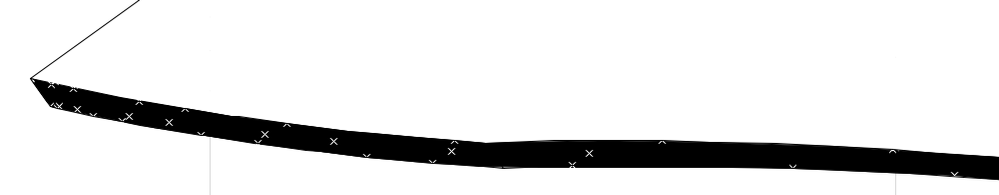

How to remove unwanted marks in a fill
I've added a fill to one of my elevations to add some depth to a certain element. The problem is that the fill is showing ' X ' lines behind it, as white marks. I'v managed to overcome this by changing the display order of both the fill and model but then I end up loosing detail in the model.
Is there any other way around this at all ?

The hotspots do not print or output anyway.
make sure You have grouping suspended
draw a marque
select a hotspot tool
hit ctrl/cmd+A
delete.
