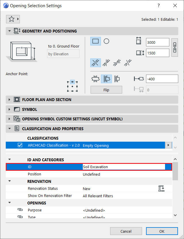

Before creating the Schedule, it is important to make sure that the Openings used for Soil excavation are in a different Layer or have a unique Element ID. Distinguishing them from the other openings in the project will make it easier to identify them and to create the Schedule. On the example below, for example, the Element ID was renamed as 'Soil Excavation'.
