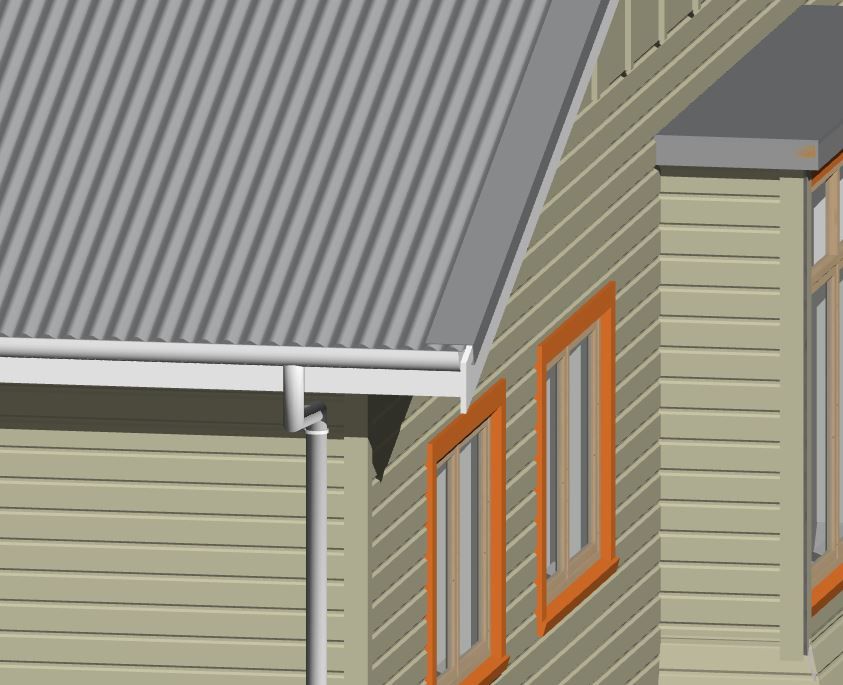

Attachment shows an example of rusticated weatherboards & board & batten (shiplap), the gutter with downpipe & corrugated roof cladding.
cadimage coverings also allow you to place the window/door facings & sills, vertical or horizontal moldings etc in one hit, nice & quick.
Yea, but that tool's expensive and it lacks a student version. Thanks 😃
